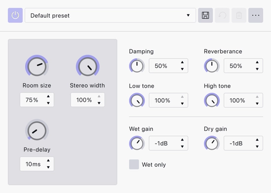

This is the same effect as Reverb in the Effect menu, added to a track’s effect stack instead of applied to its audio. The controls and what they do are identical — that page has the reference — but nothing is written back to the track: the reverb is produced as the project plays.
The Reverb realtime effect, as it appears in a track's effects stack

Because the audio is untouched, everything stays adjustable. Change the room size while the project is playing and you hear the result immediately; bypass the effect with its power button to compare against the dry track; move it above or below the other effects on the track to change where in the chain it sits; take it off the stack and the track is exactly as it was.
The reverb is included when you export, so there is no step at which you have to apply it.
